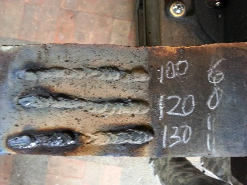

    here's a test weld using 6011:
    [IMG][/IMG]

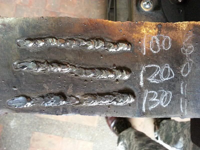

    cleaned up:
    [IMG][/IMG]
    me at the helm:
    [IMG][/IMG]
    over all impression so far:
    1. really quiet compared to my ac welder
    2. so easy to start and sustain an arc
    3. easier working on the 6011 on the powercraft than on my ac welder
    4. after using it practically the whole day and after about 1.5 kilos of rods, no overheat nor any problem so far (i guess the cool weather of Baguio helps a lot in the cooling of the machine)
    5. not so much splatter (though this may be attributed to arc length, proper voltage, etc.)
    6. verdict - so far so good...
