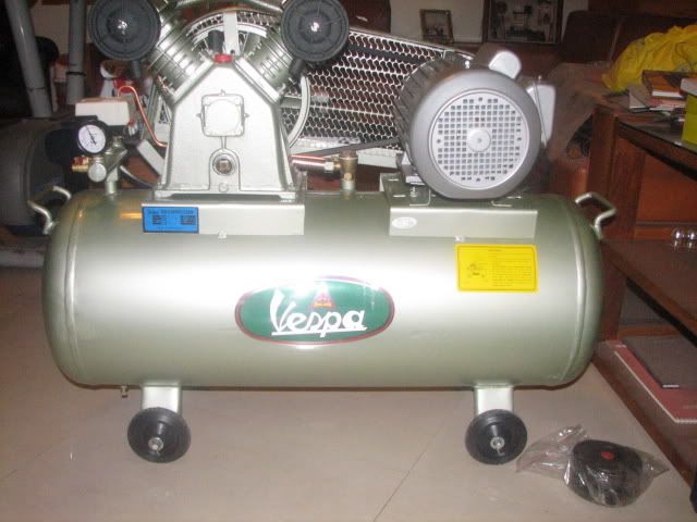

    I recently got myself a Vespa 2hp compressor and learned a lot on how to correctly choose the correct one since there are countless imitation.

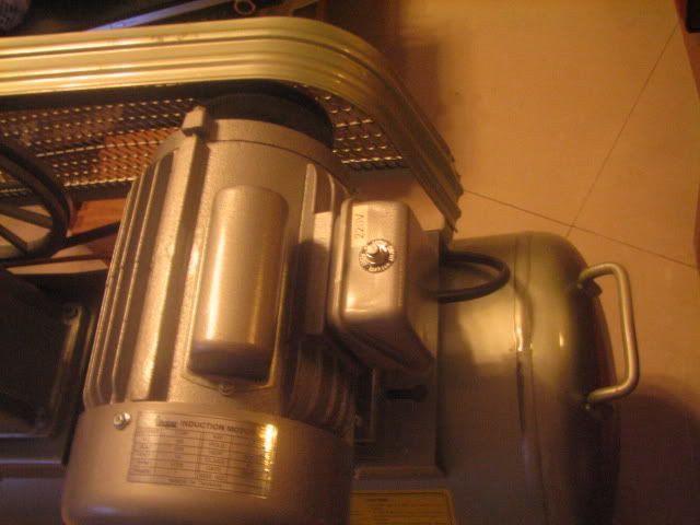

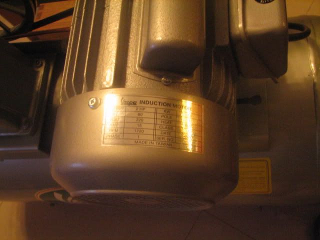

    the motor specs...
    and comes equipped with safety features...

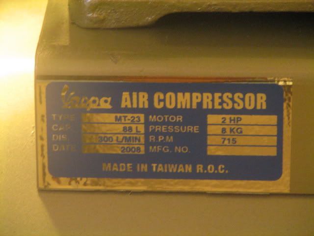

    the overall specs...

    Re: all about Air Compressors
    the hardwares...
    installing the water separator/regulator valve.
    sealing and replacing the fitting to my needs.

                            how do you spot a fake vespa from that of the original one?
