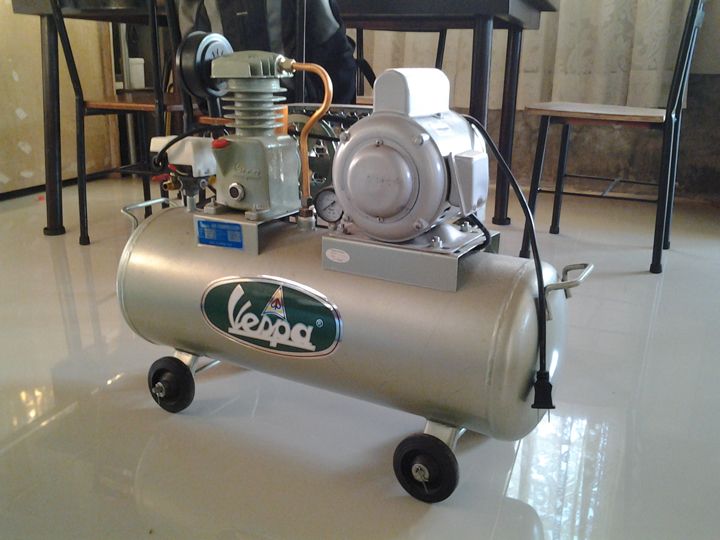

    Hello mga Brader..please help me how to FIX my broken drain valve ....I bought a new compressor....a while now...naka standby siya na full tank ...I used this for inflatables and for motorcycle tires..just last sunday I tried using it to paint some projects I have....kaso lang it spits a lot of water...so I decide to drain it...I can't really remember that I turn the Drain valve to tighten direction or loosen it , just it broke suddenly ...para naputol just on its neck so the rest of the valve part was buried inside / along the compressor tank...
    so now I need your help guys
    1.) how can I remove the broken part of the valve from the tank...
    I plan not to replace it...but to modify it like what Sir JayL did to his...put elbow and a ball valve nalang for the ease of draining....
    after the valve broke I then tried to remove the plug from the broken valve...but it broke again...these so soft like lead or what....

              Luckily my father in law remove the broken valve piece by piece....so the hole was cleared now...I did measure the opening its 1/2 inch / 13mm diameter.
              if I replace this with elbow ....I will buy the 1/2 elbow right?
                Good for you for your father in-laws' help. Now buy a stainless steel elbow, one with the thread outside and the other end with the thread inside. Also don't forget to buy the threaded plug.

                  At last ....not able to find inside and outside threaded elbow but I manage to buy a "golden" nipple....so my set goes this way...I am beggining to feel like a true PHM now....
                  have to fix this to my tank tommorow...I go to work 6 am today this is so early shot....
                    wow nice... gandang fix nito... just a reminder to put some teflon tape on the thread to prevent leak... or maybe other members have a better idea for preventing leaks on threaded tubes like this
                      yes sir nick Teflon Tape is ready to GO...
