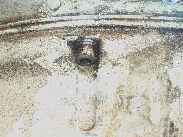

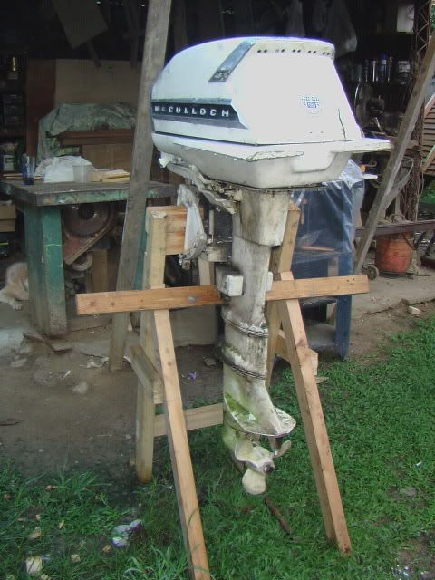

    I have this 45hp outboard motor circa 1965. I need to open up the lower part but I can't get all the bolts out.
    I only was able to remove 4 of the 8. Another problem is that the bolts are in a position that will not allow me to use a bolt extractor. How do I remove them?
    Here is a picture of one of the stuck bolts:

    you have a couple of options:
    1. Soak it overnight with WD40.
    2. If its an all steel assembly you can freeze it with a can of freezing spray.
    3. If there is no danger of combustion and its aluminum assembly you can heat it up with a butane burner.
    4. if all things fail, drill out the bolt head and use an extractor on the thread.
      Re: How to remove a frozen bolt
      Thanks but No. 4 is not an option because I would not be able to position the drill inline with the bolt head. I think I'll try the heating method. I've a cutting torch and that should do the trick. I'll of course use a cold flame.
      Any suggestions on dealing with the loose allen head? I'm thinking I might grind down the next size allen key o maybe weld a regular hex bolt.
