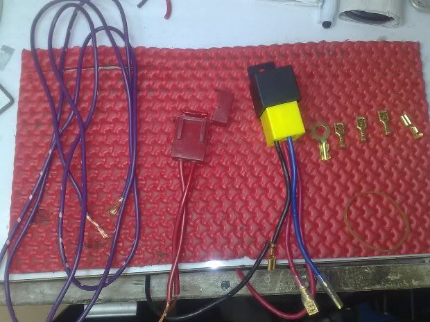

    after market horn installation:
    things you'll need
    wire 14 to 16 gauge
    relay
    relay holder
    fuse 10 to 15amps
    fuse holder
    female connector
    ring connector
    electrical tape or shrinkable tubes para mas malinis tignan

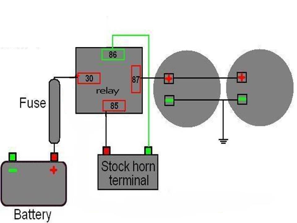

    just follow the diagram...
    eto po kung gusto nyong palitan totally yung stock horn nyo
