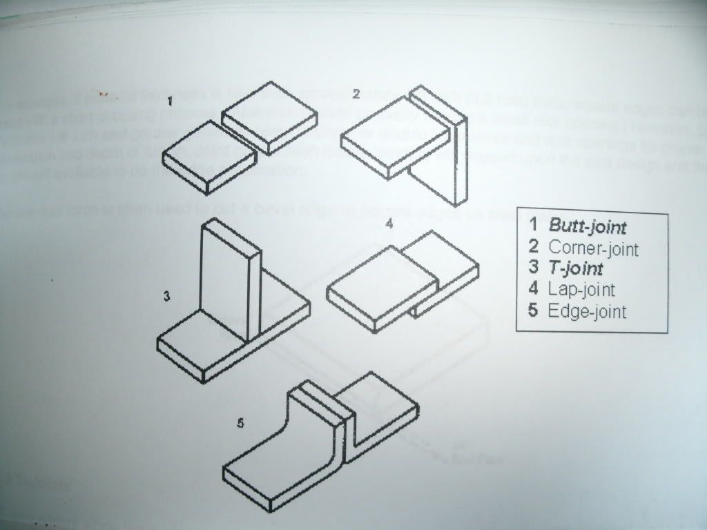

OH before we go to another type of welding position allow me first to add some images I know would be very beneficial to all interested in this type of welding. Its not just being able to know how to apply or lay the beads on the metal surface but also knowing how to identify possible joints we may encounter when we do our metal projects in the coming days or so. 😎
These images are still worth studying and understanding, so we may plan how we would apply our welds properly and get very satisfactory results. 😉
These are different types of welding joints:
1.) BUTT-JOINT
2.) CORNER-JOINT
3.) T-JOINT
4.) LAP-JOINT
5.) EDGE-JOINT
Posted : 28/07/2012 7:40 pm
Re: Let's practice STICK WELDING, and proper weld bead applications.
* BUTT JOINTS *
A BUTT JOINT occurs when the surfaces of the members to be welded are in the same plane with their edges meeting. Butt joints can be designed in various ways, the edges can be square, beveled, or grooved. Edges may be held tight together or a small gap is provided and known as a root opening, this opening may be left between the edges.

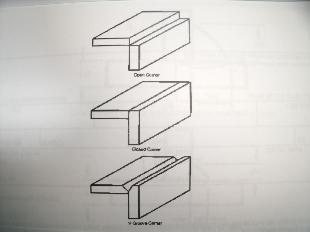

* CORNER JOINTS *
When members to be welded come together at weld is usually made about 90 degrees and take shape of an " L ", they are said to form a corner joint. These joints are quite easiily assembled and require little joint preparation. After welding, the welds are generally finished, that is, grinded to smooth attractive appearance.
* T-JOINTS *
A T-Joint occurs when the surfaces of two members come together at right angles (90degrees) and take the shape of a " T ". On this particular type of joint, a fillet weld is usually made. T-joints offer good mechanical strength especially when welded from both sides.
* LAP JOINTS *
Lap Joints occur when the surfaces of joined members overlap one another. It has good mechanical properties, especially when welded on both sides. The weld form used on a lap joint is generally a fillet weld.

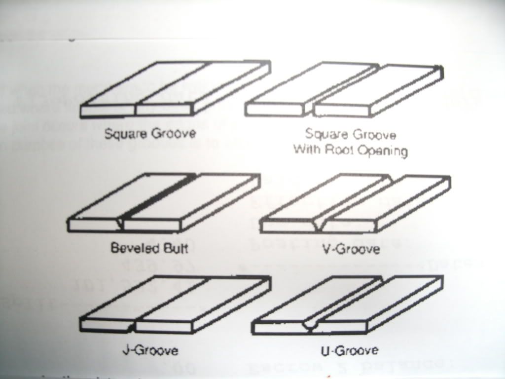

* EDGE JOINTS *
Edge Joints are often used when the members to be welded will not be subjected to any great stresses. An edge joint occurs when the edges of parallel or nearly parallel members meet and are joint by a weld.
And the main purpose of these grooves is to allow proper penetration or depth of fusion.

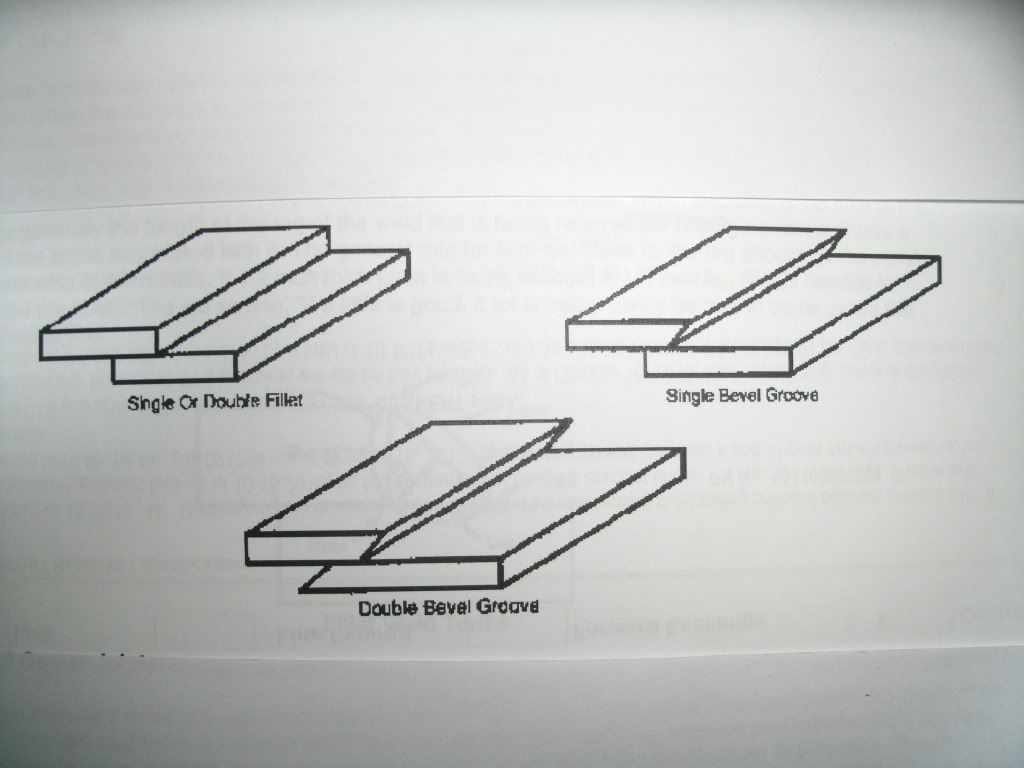

And speaking of GROOVES, here are some types of Groove Designs ......................
HOPE YOU GIVE THIS SOME STUDY AND CONSIDERATION !!!!! :rolleyes:

SORRY ADMINS if I posted the images on full size, I purposely made it that way since all naman are just line drawings, it would be easier for viewers to understand and see clearly the images illustrated, I hope you do understand my intention.
Thanks po muli !!!!!!!!!!!
